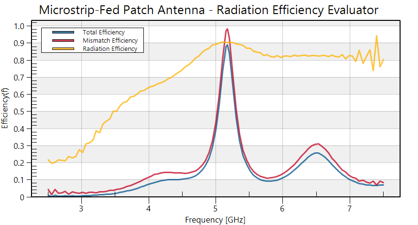

It is in general difficult to know in advance what convergence level is necessary in order to achieve the desired accuracy.
There are tell-tale signs that convergence level is too low when results look like this:
Changing the convergence level from "medium" (-50dB) to "strict" (-80dB) yields in this example a much more satisfying result:
