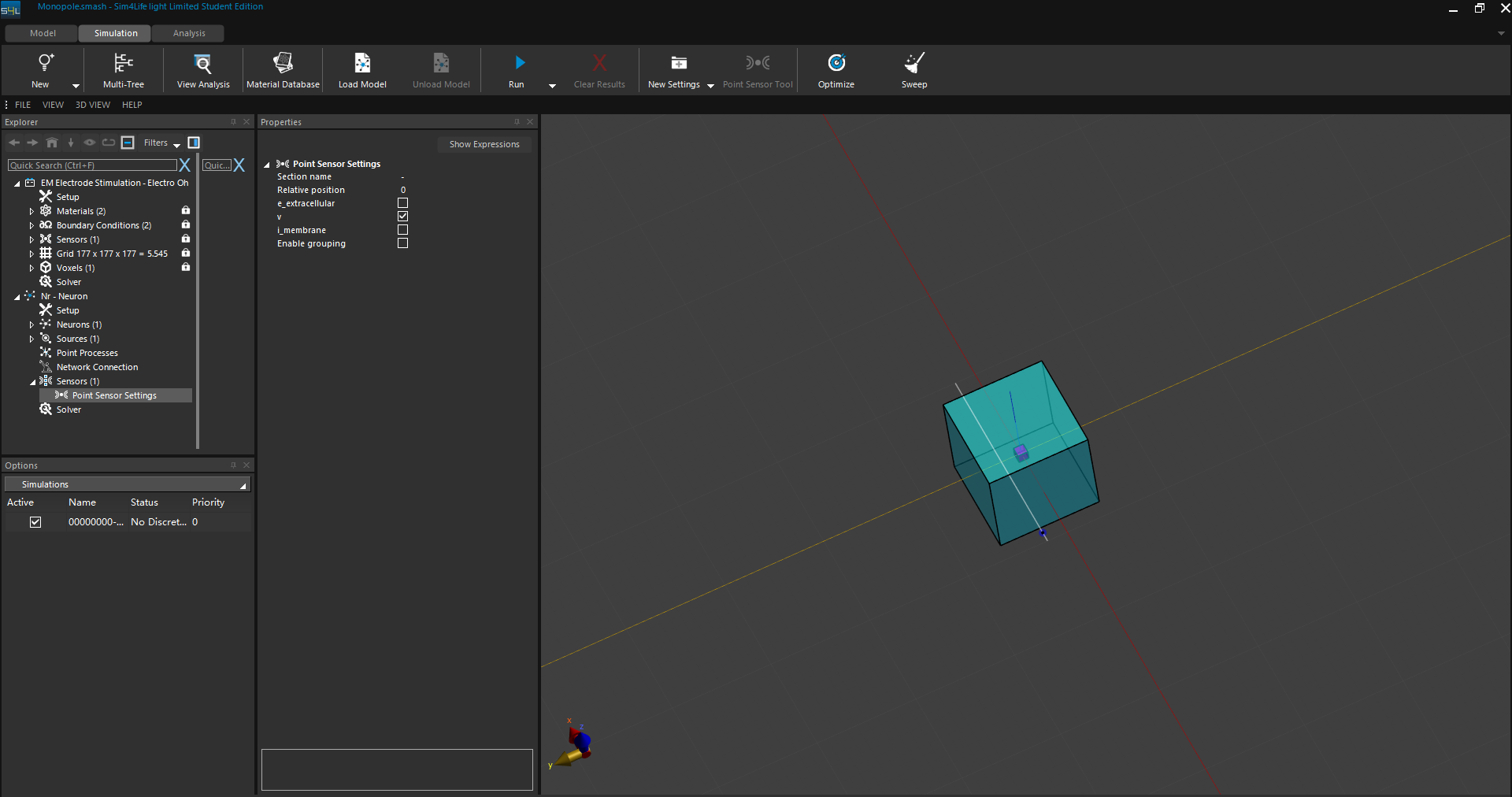

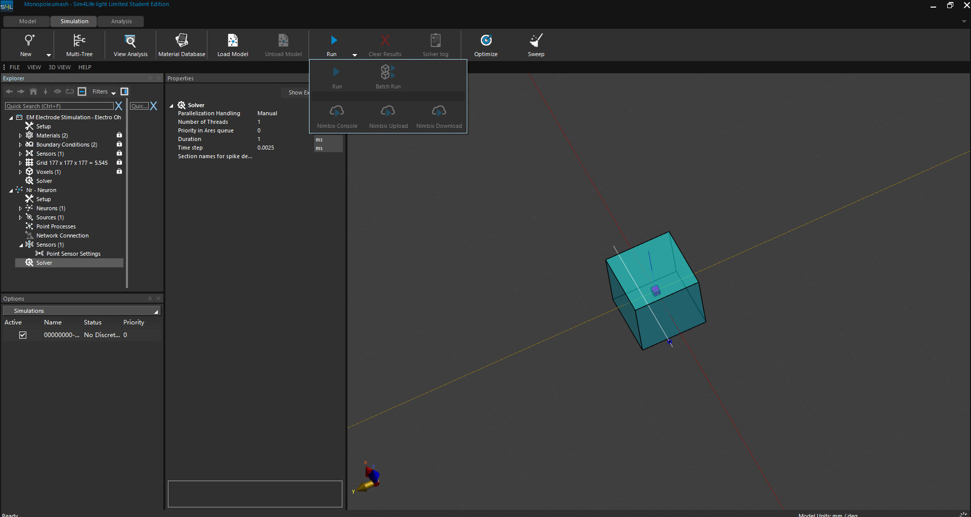

    hello,everyone. When I import the tutorial of monopole in neuro tutorials.As the picture shows, the point sensor tool button is gray and I can't click it.
    and the run button is gray, too.I can't run the solver. I ensure I have loaded the model and the log shows the model loaded successfully. I don't know what the problem is. Hope you can reply me and help me.

      Hello,
      It seems that you now have the Neuron installer and it is working, but something is missing in your setup.
      Could you please check for error messages in the Console?
      One possible reason could be that you have installed NEURON before Sim4Life completely finished its installation.
      Please uninstall Sim4Life, install it again, and only after finishing install NEURON.
