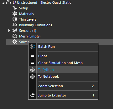

              You probably know this already, but for the sake of completeness (and for the other readers) note that you can find the Python equivalent of most (and ideally all) simulation settings by setting up a simulation in the GUI, changing the desired parameters from their default values, right-clicking on the simulation and choosing "To Python" in the menu. This should create a script visible in the Scripter window (click VIEW -> Scripter if it is not visible).
