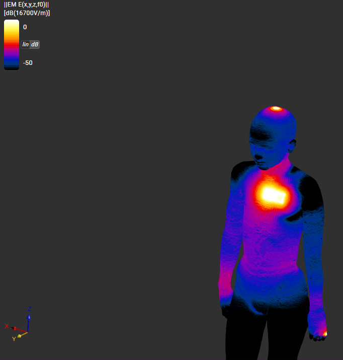

    Hi Everyone,
    I'm currently learning Sim4Life and working through a simple use case involving electrical stimulation applied around the chest area. I'm using one of the ViP anatomical shells with muscle material properties assigned uniformly to the entire body.
    After running the simulation and analyzing the electric field, I noticed unexpectedly higher voltage spots at the extremities-specifically the head and hands as shown in the figure below.
    Does anyone know what might be causing this? Is it a numerical artifact, meshing issue, or something to do with the solver settings or boundary conditions?

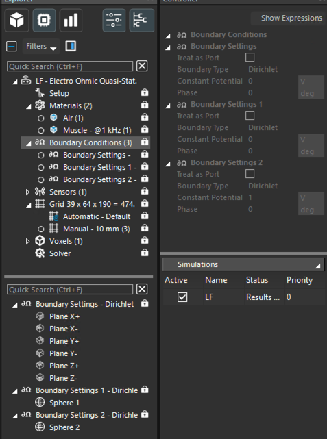

        I wanted to share more context about my simulation setup to help troubleshoot or clarify the results I’m seeing.
        Solver: Electro Ohmic Quasi-Static
        Frequency: 1000 Hz
        Model: Billie whole-body shell (material: Muscle from the library)
        Electrodes: Two electrodes placed on the chest area
        Boundary Conditions:
        Dirichlet boundary automatically applied to the external bounding planes
        Dirichlet boundary applied to both electrodes, set as “Treated as Port”
        Simulation Combiner – Channel Parameters:
        Electrode 1: Amplitude = 500 V, Phase = 0°
        Electrode 2: Amplitude = 0 V, Phase = 0°
        Does this configuration look correct?
        Thanks

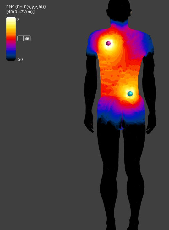

            If I run a simulation similar to yours, but NOT setting the Dirichlet boundary conditions to "Treat as Port", I get something that looks like what you probably expect:
