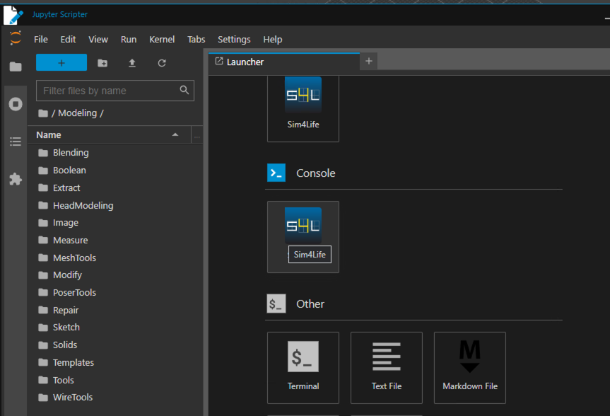

      To see the full modeling capabilities you probably will need to also look into the Python module XCoreModeling. The high-level API in s4l_v1 only contains a subset of that API.

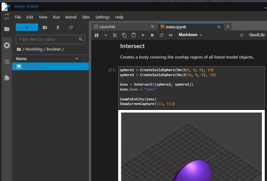

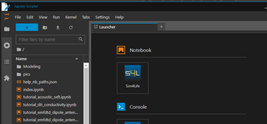

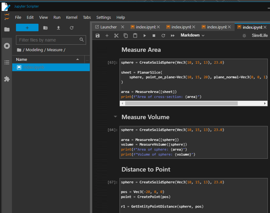

      The Jupyter notebook snippets/examples demonstrate many functions. Please have a look at the tutorials and the topics demonstrated in the Modeling folder
