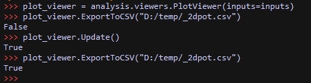

    I want to output the results of the EM simulation "EM U(t)" as a csv file, but I can't save it.
    Please tell me the reason.
    Thank you in advance.
    # Adding a new PlotViewer
      inputs = [em_sensor_extractor.Outputs["EM U(t)"]]
      plot_viewer = analysis.viewers.PlotViewer(inputs=inputs)
      plot_viewer.visible = True
      plot_viewer.ExportToCSV("C:/Temp/test.csv")
      plot_viewer.UpdateAttributes()
      document.AllAlgorithms.Add(plot_viewer)
      wrote on last edited by bryn
      you need to call plot_viewer.Update() before exporting to csv
      the method returns False if you have not updated the viewer... (btw, I agree this is a bit unintuitive, the ExportCSV could do the update ...)

        The problem has been resolved!
        Thank you for your assistance!
