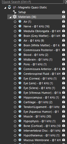

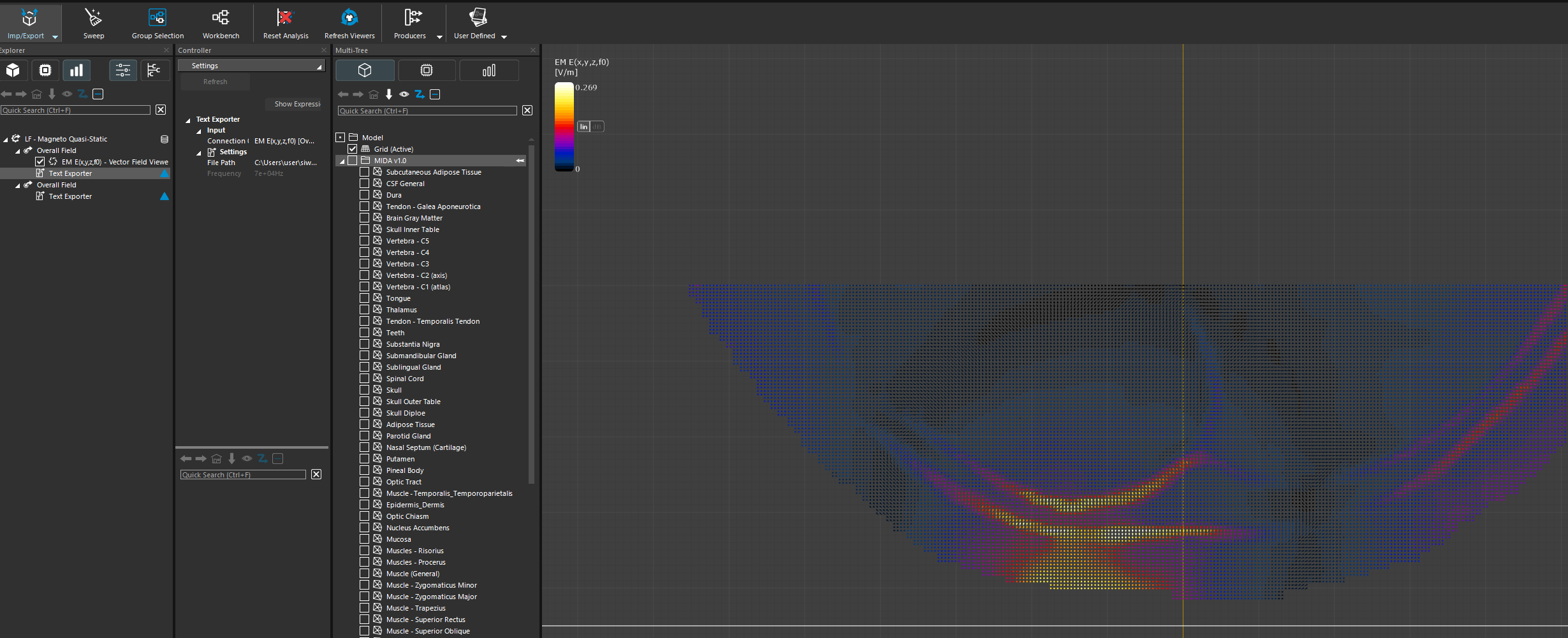

    Hello, I'm posting this because I encountered an issue during a TMS simulation with MIDA
    When I try to export the EM E-field results from the Quasi solver to a text file using the text exporter, all values appear as NaN if the material properties are set to vary with frequency(like IT'IS LF) instead of being fixed(generic). I would appreciate any advice on how to resolve this issue.

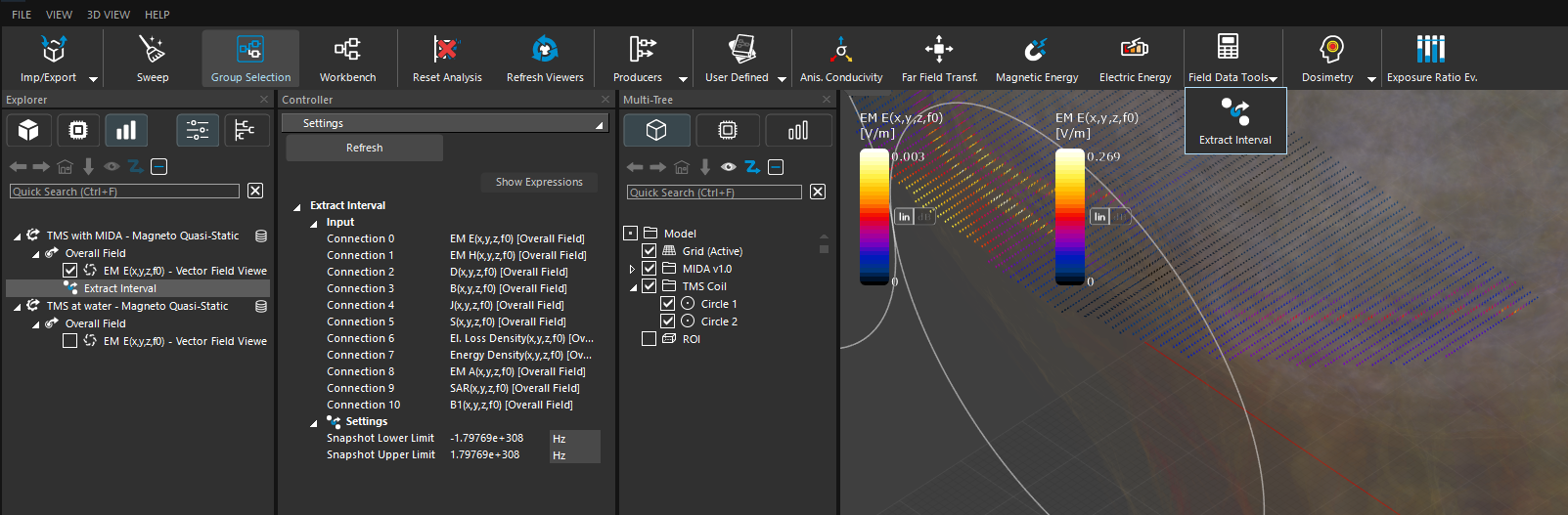

        @halder
        Thank you for your answer.
        However, I cannot find the NaN filter under the Field Data Tools. I also have two hardcover manuals, Applications & Tutorials and Professional Handbook(Release 7.2), but neither of them includes a Chapter 13.10.14 Could you please clarify which manual you are referring to and how I can access it?

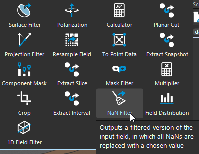

        • H Offline
          H Offline
          halder
          Please select the overall field and select the E field, then look under "Field Data Tools". Please "Go to the HTML manual" from "Help" and search for NaN filter. I would recommend using the latest version of Sim4Life v9.0.
