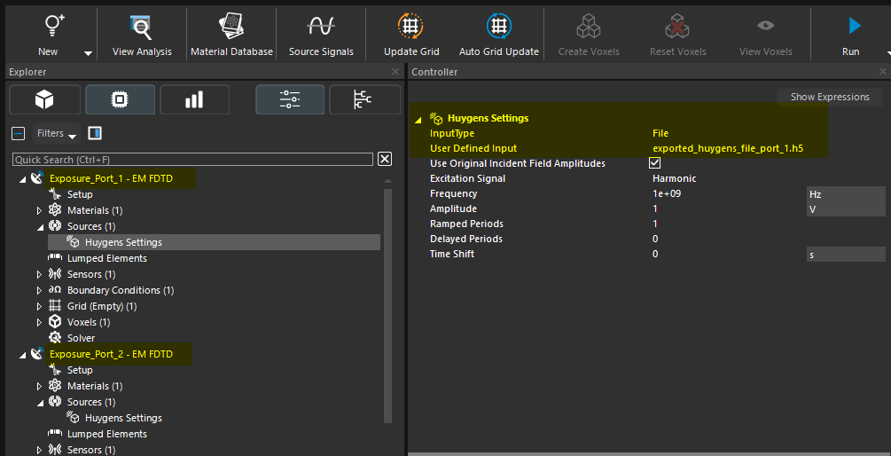

                    Do you have an idea, how to overcome this issue:
                    To link (as in the youtube tutorial) the Exposure simulations (using the Huygens box) with the simulation of the source, the FieldSensorCoil of the source simulation is drag-dropped in the simulation of the body exposure.
                    This link wont be available for simulating the BC Coil with Multiport Simulations, exporting the individual port fields, importing these as Huygens sources in the Exposure Single-Port Simulation? That is correct?
                      Sylvain
                      #10
                      Hi Lisa,
                      You are correct. It won't be possible to link a single multiport simulation with several individual single-port source simulations.
                      However, you can have multiple single-port "exposure" simulations, each linking to a Huygens source file (the one you exported using the Huygens Exporter, for each port).
                      The results can be combined "manually" at post-processing, using the Field Combiner. Note that this algorithm simply does a weighted sum of its inputs, so if you want to compute SAR you have to use it on the E fields, and compute SAR on the combined E field.
                      I can explain in more detail if any of this is unclear, feel free to ask (in that case, please provide a more comprehensive overview of what you are trying to achieve).

                        #11
                        Hi Sylvain,
