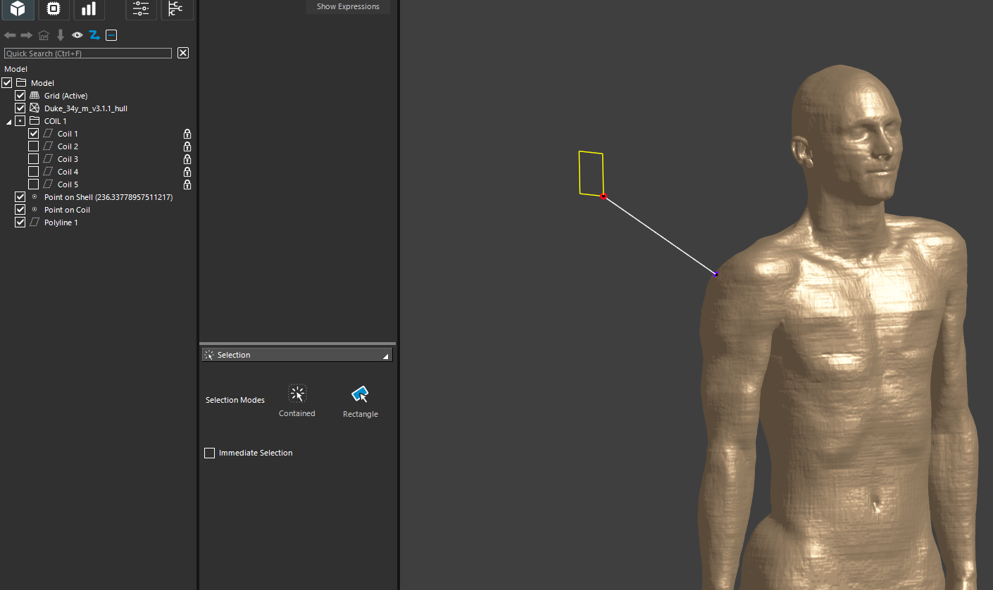

    Hi, I would like to calculate the distance between an antenna and the bone surface perpendicular to the antenna. What would be the best way to approach this?

      To measure the shortest distance between two entities, you can use the Python API:
      import XCoreModeling as xcm
      shell = xcm.GetActiveModel().SelectedEntities[0]
      coil = xcm.GetActiveModel().SelectedEntities[1]
      res = xcm.GetEntityEntityDistance(shell, coil)
      print(f"Shortest distance shell-coil: {res[0].Distance}")
      p1 = xcm.CreatePoint(res[0].ClosestPosition)
      p1.Name = "Point on Shell"
      p2 = xcm.CreatePoint(res[1].ClosestPosition)
      p2.Name = "Point on Coil"
      # This line is just to visualize where the measured distance was taken
      line = xcm.CreatePolyLine([res[0].ClosestPosition, res[1].ClosestPosition])
      This would create something like this:
      Some other snippets are shared here: https://forum.zmt.swiss/topic/565/geometry-modeling-snapping-to-endpoints-in-python-api/3?_=1747746585465
