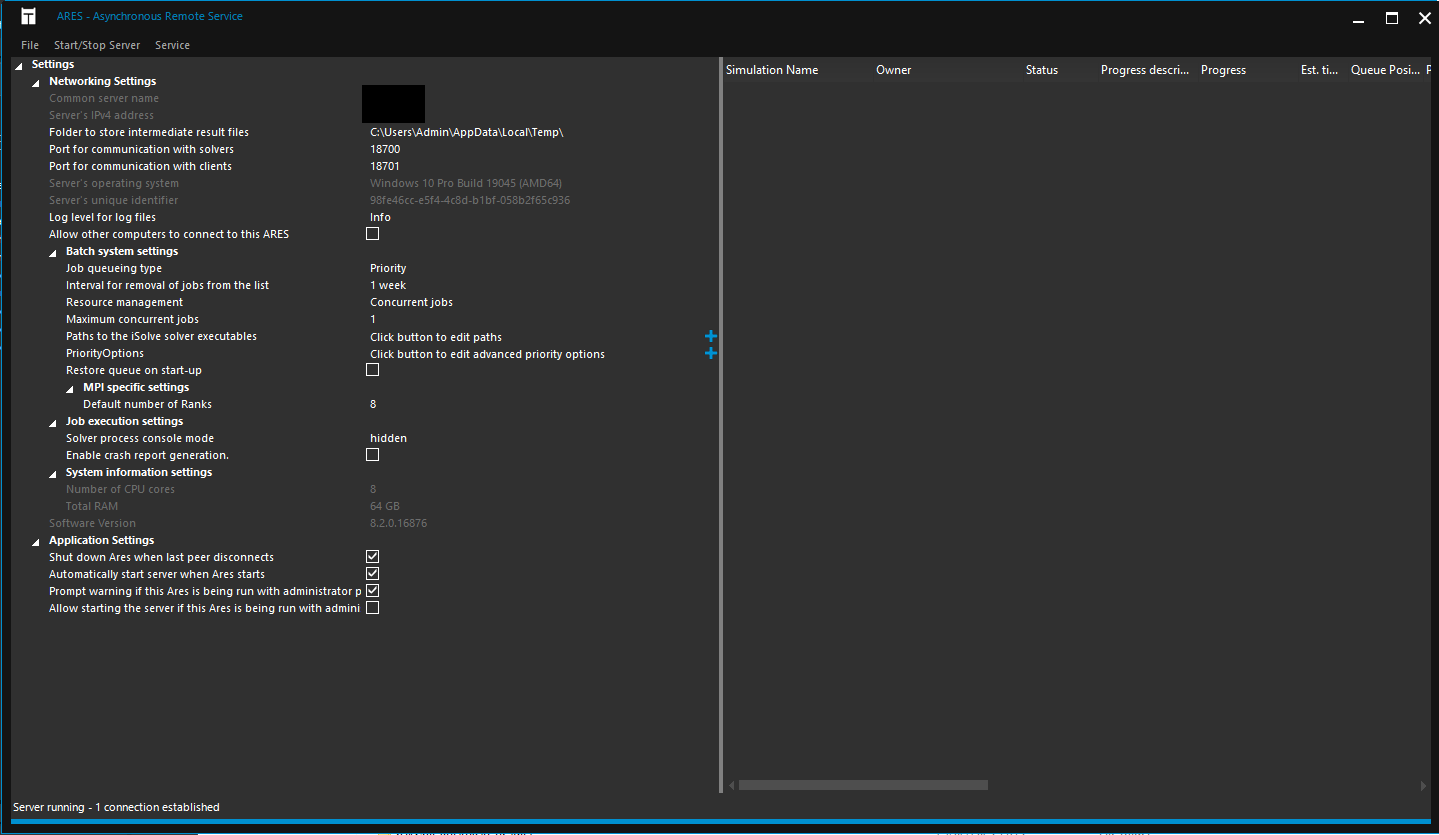

          It is not showing up as in the S4L documentation when I open Ares, see attachment.

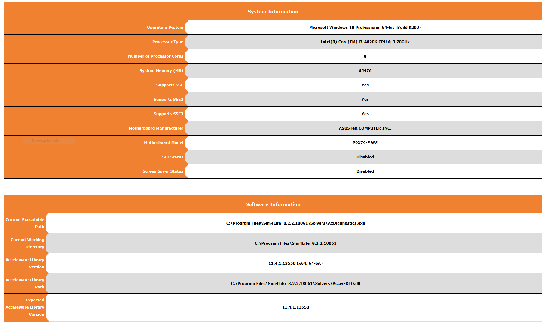

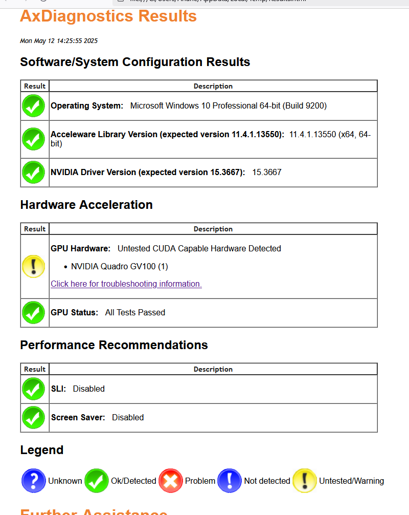

          In case it helps, I also ran the Acceleware Diagnostic Tool and it looked fine (see attachment).

            I ran the AxDiagnostic tools also for V.6.2.1.4972 and only found a driver conflict for V.6.2.1.4972 as one would expect (the image from above was for V8.2.2.18061).

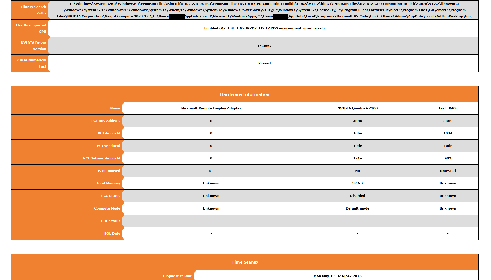

                thanks for the reply. I have tried both options and to be sure I just reinstalled without deprecated drivers one more time, but to no avail. I have also set AX_USE_UNSUPPORTED_CARDS=TRUE as stated in the manual. I also ran AxDiagnostics again and I'm attaching the detailed results in case it helps.

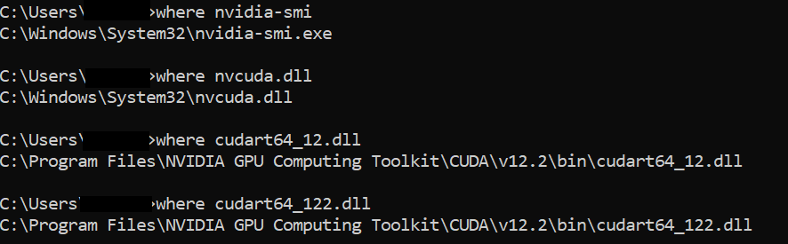

                  Could you also share the location of nvidia-smi.exe on your PC? This is used by the software to get GPU information.

                    yes, see below. I've also included some other files that ChatGPT suggested may be relevant in case it helps.

                      If Ares cannot locate your GPU, it could be due to the installation location of nvidia-smi.

                            After a call with S4L support, here is the solution for future reference:
