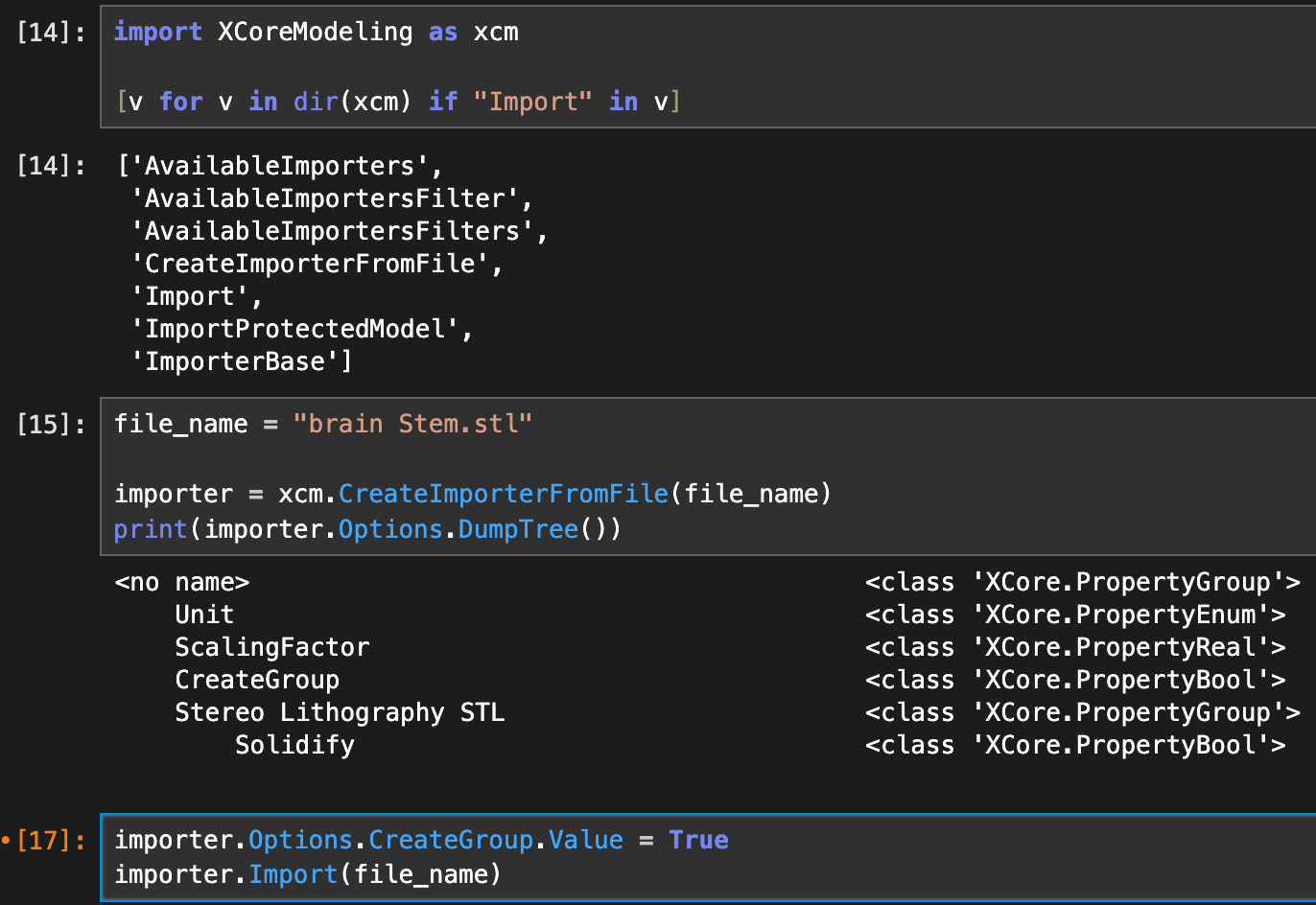

      I am not sure this possible atm. Normally, you can find the options by creating an importer object and calling DumpTree on the Options, to see the names of the options.
      It seems though, the Solidy option is inside a group with spaces in the name ("Stereo Lithography STL"). The name of the property cannot have spaces, so it is not accessible, e.g. by writing
      importer = xcm.CreateImporterFromFile(file_name)
      importer.Options.Stereo Lithography STL.Solidify.Value = Tre
      I guess you could traverse the property group to find the child called "Solidify" and set it's value to True. We will investigate and make this option accessible for the 9.0 release.

        the "Import As Solid" issue is fixed in the dev version. In 9.0, you can do this
        importer = XCoreModeling.CreateImporterFromFile(file_name)
        importer.Options.Solidify.Value = True
        entities = importer.Import(file_name)

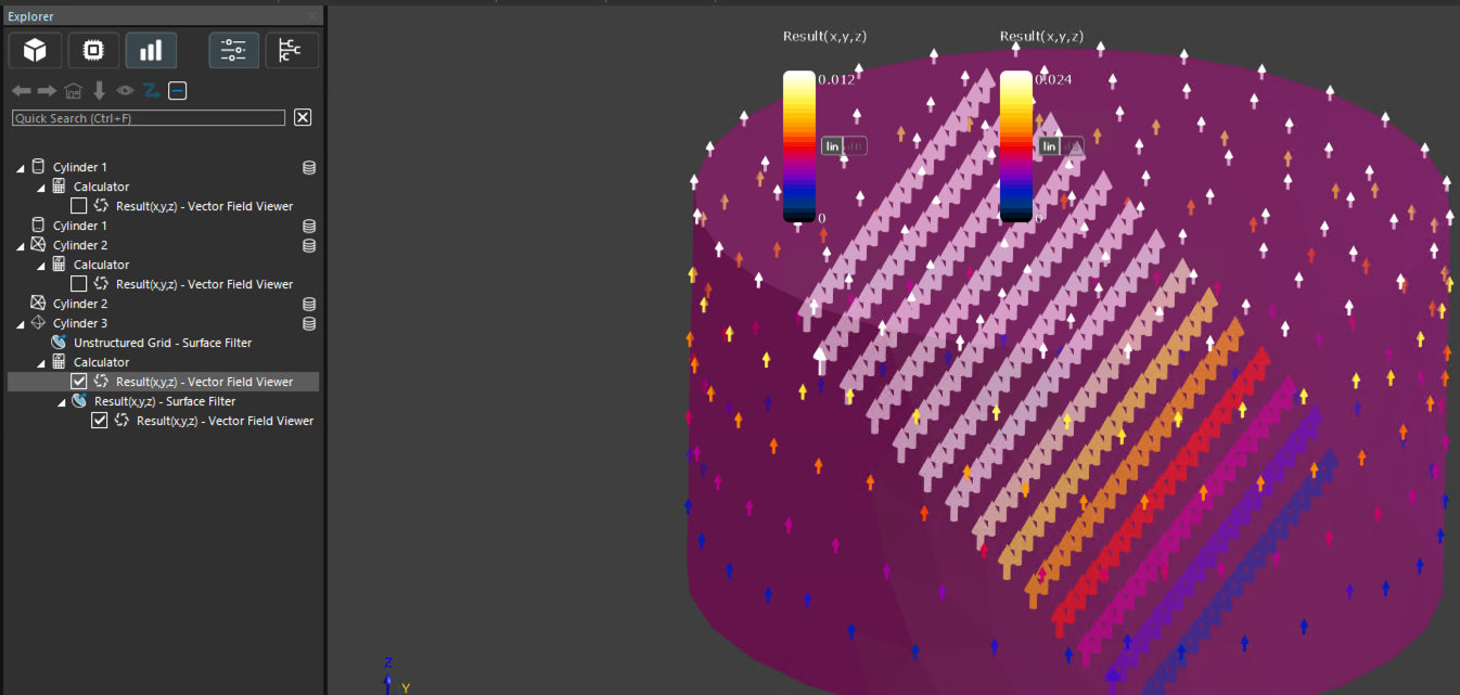

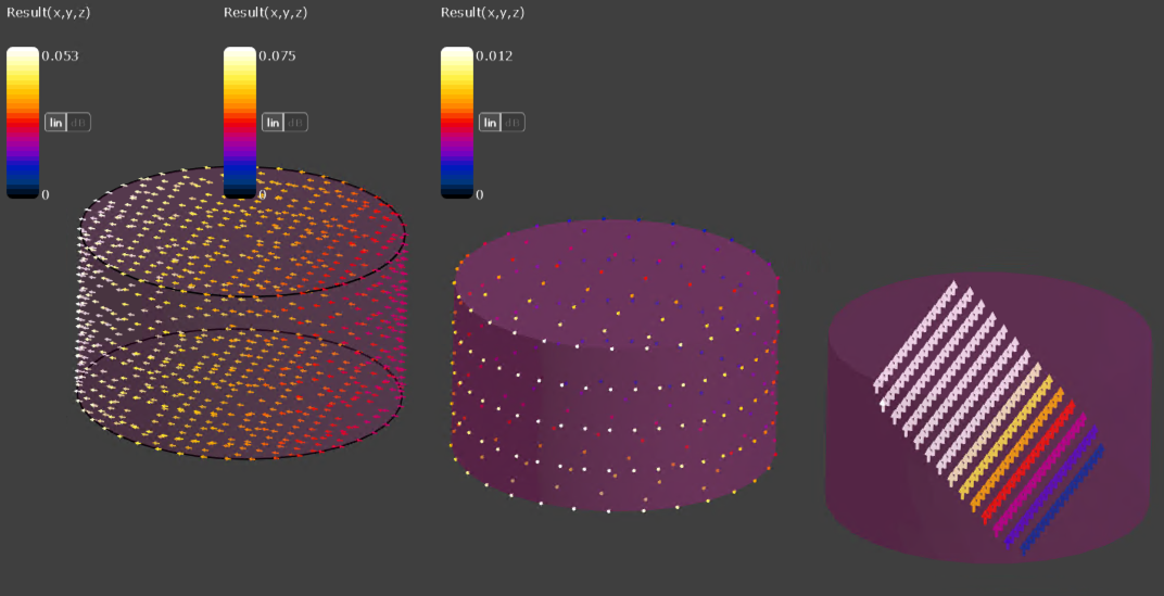

              1. I tried to reproduce this doing the following. I create three entities
              • a cylinder
              • copy it and convert the copy to a triangle mesh
              • generate an unstructured tetrahedral mesh
              1. Then I drag these entities to the Analysis (ModelToGridFilter in Python API).
              2. I tried to use the surface viewer, but since they have no fields, nothing is displayed (this changed since 7.0 or before - it used to display a white surface).
              3. To generate a field I used the Calculator, and added expressions like coordsY*jHat, i.e. (0, coordsY, 0) where coordsY is the y-coordinate from the points in the geometry.
              4. Create a vector viewer for each (from the left: Solid Body, TriangleMesh, UnstructuredMesh). The third one samples vector values using Line/Plane/Box sources.
              1. To get the vectors on the surface of the UnstructuredMesh, I had to first extract the surface, via Field Data Tools -> Surface Filter
              The generated Python ("To Python' in context menu) script for item 5 was:
