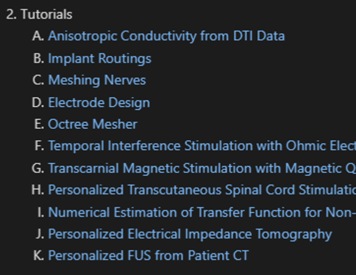

    I would like to highlight our new jupyter notebooks released in Sim4Life 9.0 (18820) demonstrating how to setup simulations for personalized modeling, starting from medical image data (MRI or CT). You can find them under Help -> Examples, tutorials H, J and K.
    These new tutorials show how to
    • import medical images
    • run automatic segmentation of the trunc
    • extract surface models from the labelfields
    • assign material tags to simplify automatic assignment of material properties in the simulations
    • extracting anatomical landmarks on the skin for placing electrodes
    • setting up a simulation and running it

          hi,bryn. Upon discovering your post, I downloaded the latest software version—9.2.1.19976. However, I was unable to locate the H. Personalised Transcutaneous Spinal Cord Stimulator. Might you kindly advise where I might find this?@bryn
