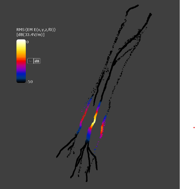

    I would like to extract the magnitude of the electric field only in the nerve region when a voltage is applied to the arm, based on the manual section 3.6.3 “Yoon-Sun Arm Stimulation,” using MATLAB. How should I approach this?
    Also, when I try to visualize the electric field only in the nerve region using a mask filter (setting everything except Nerve_〇〇 to 0), the result appears discontinuous, as shown in the attached image. For the grid, I have set the maximum step and geometry resolution to 0.5 mm for all directions.スクリーンショット 2025-10-09 162023.png
      if it is discontinuous, then the voxel resolution was not sufficient to voxel the thinnest region of the nerve.
      you can enforce continuous voxeling by dragging the nerve trajectories (splines/polylines) to the material settings (assign to "Nerve" material) and voxeler settings (assign a higher priority). The voxeler will assign all voxels intersected by the trajectories to "Nerve".
      Warning: Note that for coarse voxels this will exaggerate the diameter of the nerve.

        @bryn
        Thank you for your reply.
        I followed the tutorial and set a high priority for the nerve region, but the visualization still appears discontinuous. However, when I applied a mask that sets all regions except the “nerve” and “neuron” to zero, the field became thicker but displayed smoothly, so I will proceed with this approach for now. (If there are any other possible improvements, I would appreciate your advice.)
