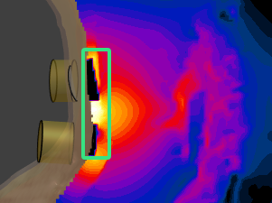

                @halder I hope this message finds you well. I am currently conducting a temporal interference (TI) simulation using the LF Electro Ohmic Quasi-Static solver in Sim4Life, and I have encountered an issue regarding the electric field distribution at the electrode–skin interface.
                Here are the specific settings I used:
                There are four electrodes in total.
                For the first pair of stimulating electrodes, I assigned PEC material type to the other two electrodes (which are not used for stimulation).
                The stimulating electrodes were not assigned a material type; instead, I only applied Dirichlet boundary conditions to them.
                In the voxel settings, the four electrodes were set with priority = 1, and the Duke model with priority = 0.
                For the second pair of electrodes, I applied the same procedure accordingly.
                However, during post-processing, I noticed that the region where the electrodes overlap with the skin shows no electric field distribution, which seems physically unreasonable.
                Could you please advise if there might be an issue with my setup or if there are additional steps required to properly model the electrode–skin contact in TI simulations?
