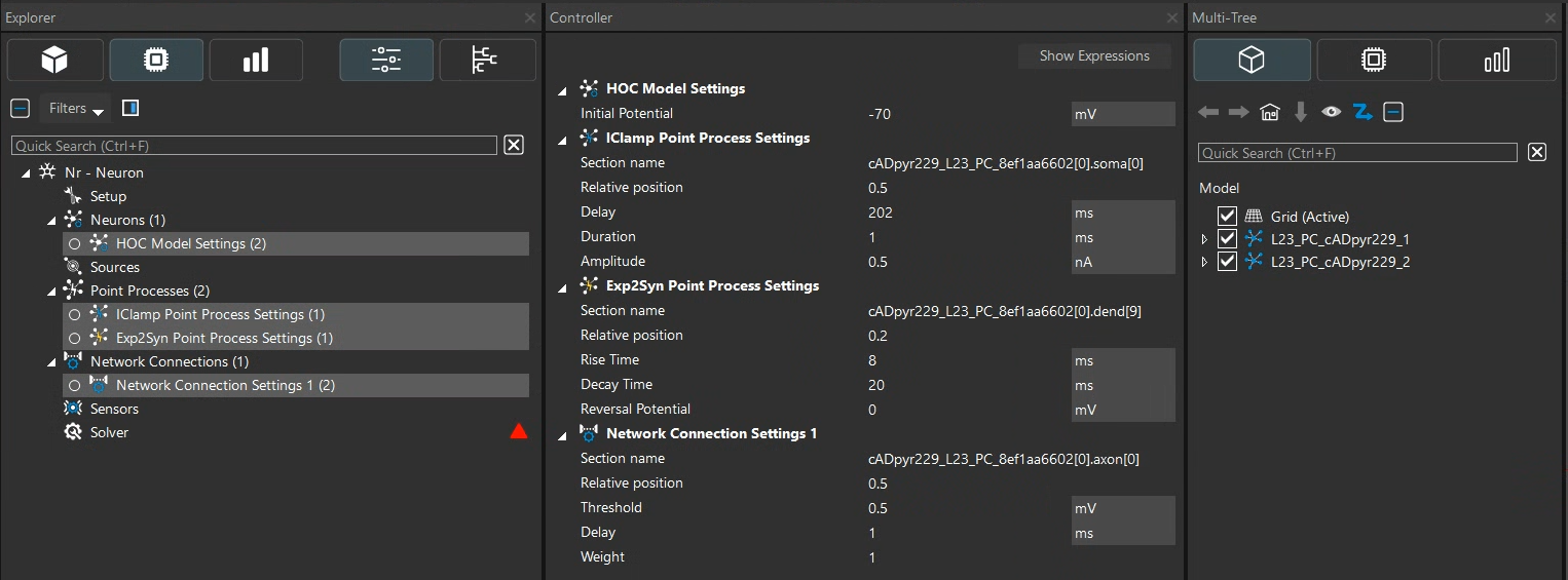

    Hi, I'm trying to simulate a synapse between two identical neuron models, imported from the same .hoc file.
    I set the simulation as follow (see screenshot):
    -both neuron have the same HOC Model Settings
    -The first neuron "L23_PC_cADpyr229_1", pre-synaptic, has an IClamp on its soma
    -The second neuron "L23_PC-cADpyr229_2", post-synaptic, has a Exp2Syn point process on dendrite 9
    -The network connection was created drag & dropping the first neuron's model and the Exp2Syn point process of the second neuron in the network connection settings
    If I try to run the simulation I get the error messages:
    Simulation : [Error] Failed to create neuron group ids.
    Error : Failed to write the input file
    Error : Unable to start simulation: failed to write input files.
    How can I solve this error?
    I already tried using different neurons from different .hoc files.
    Thank you in advance

      To use multiple instances of the same HOC file in a single simulation, the neuron model must be defined as a HOC template (see Manual section 2.13.4.7.2, “HOC Templates”).
      In a non-templated HOC file, section names are defined globally. Loading the file more than once therefore creates duplicate section names, which NEURON does not permit. A template gives each neuron instance its own namespace, allowing multiple instances to be created and connected without naming conflicts.
      Please also ensure that the HOC template meets Sim4Life’s compatibility requirements, including matching the file and template names and placing the compiled mechanisms in the same folder as the HOC file.
