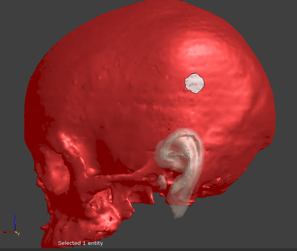

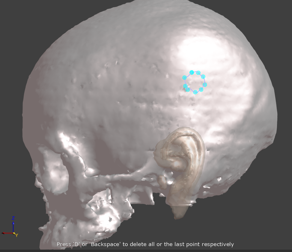

      Hi, this video is very useful. I am following what you shows here and trying to creat a patch on the surface of a head model. However, it seems that I created a patch not inside the loop, but outside the loop (see attached screenshot). Do you know how to solve this problem?
        the orientation of the loop matters
        • clockwise: create patch inside the loop
        • counter-clockwise: create patch outside loop
        R 1 Reply Last reply
        • brynB bryn
