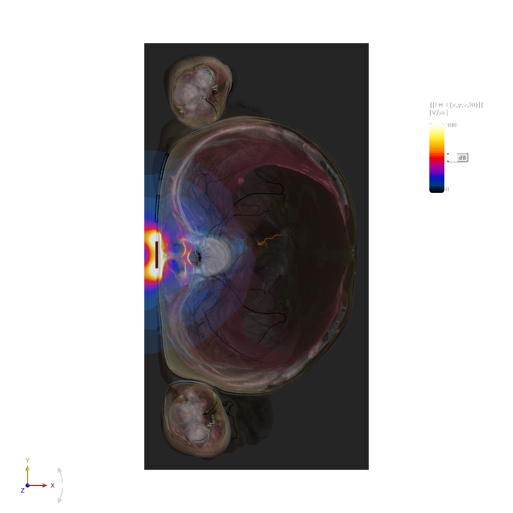

        This is what I'm after:

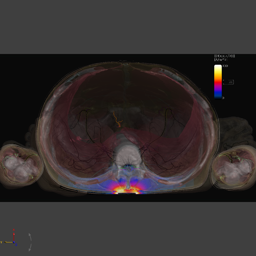

        This is what I'm getting:

          Good question. The rotation of the camera around the view direction is not so easy to specify in the API.
          I can suggest the following workaround, in your target image the 'right' direction is negative Y
          cam = XRenderer.CameraSettings() # create a camera
          cam.Distance = 100  # instead, you could zoom to the bounding box, as shown in the Jupyter notebook examples
          cam.SetViewDirection(Vec3(0,0,-1), Vec3(0,-1,0))  # specify view direction and 'right' direction
          XRenderer.RestoreCamera(cam)  # tell the GUI to use these camera settings

              Nice one @bryn , that seems to work well. Thank you.
