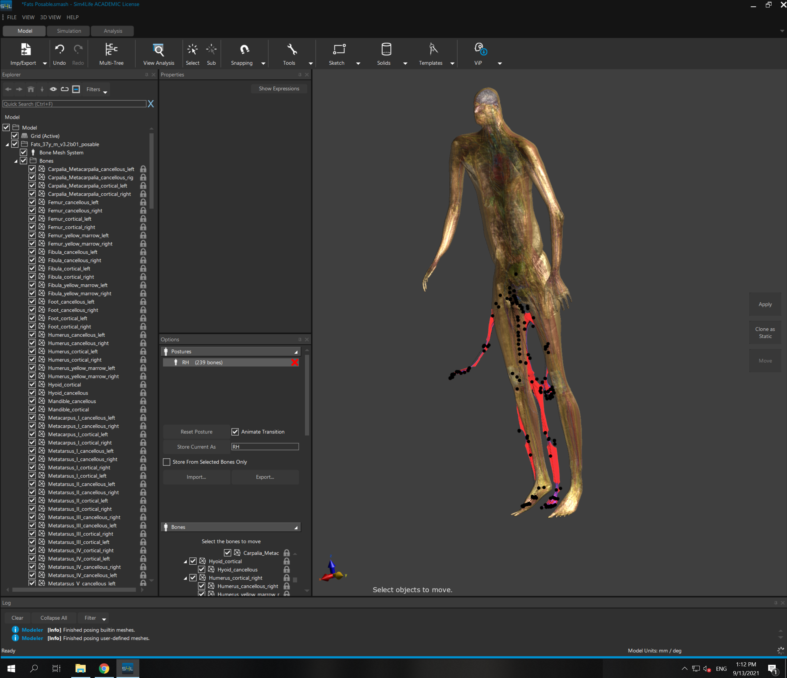

  • vi-zoo mouse model downloading
    0 Votes
    2 Posts
    1k Views
    brynB
    The model is posable, and the locks prevent the user from modifying the individual surfaces which may break the posable model. If you need to edit (e.g. cut) individual surfaces, you can select the folder containing the model or the bone mesh system and choose "Clone As Static" from the context menu. This will create a non-posable copy (without locks).
